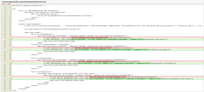

I guess that's what I was trying to ask...I see the screenshot and the green and red highlighted code, but no instructions...is that code to be removed, modified, or did I miss something? Thanks.
Red is the current code in 1.0.3, green is the new code in 1.0.4.
It's just being shown as a reference as to what has been changed.
