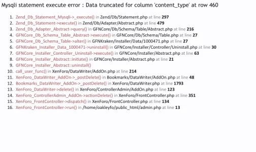

Got this error when trying to uninstall Good For Nothing Kraken and install the latest Image Optimizer Package - Any suggestions:
