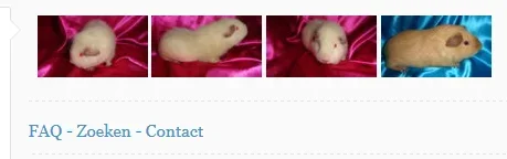

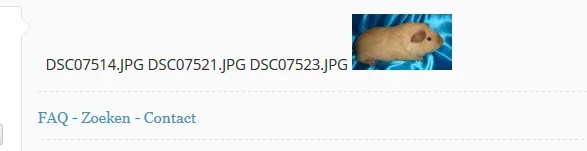

Still found a bug
Some uploaded pictures are not displayed.
If I disable the add-on does it right
Enabled
Disabled

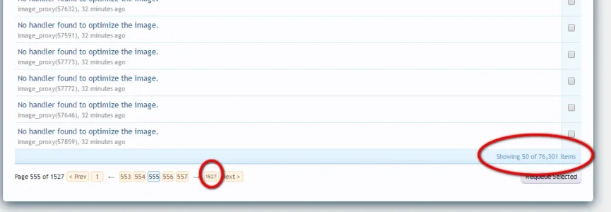

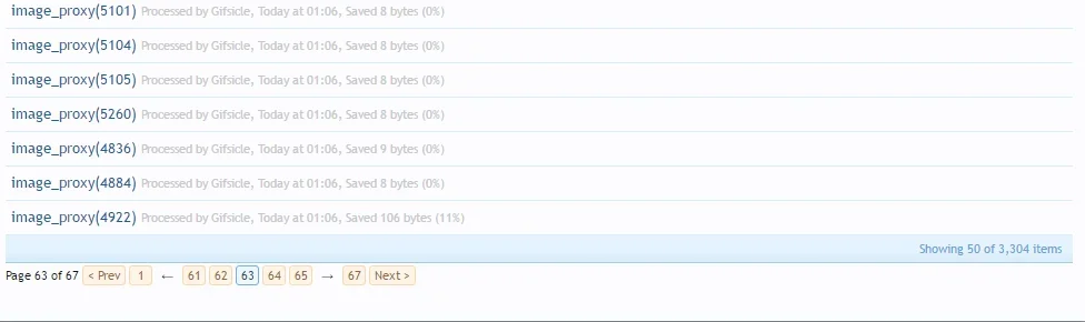

I also think that Optimus not working.
I tried to rebuild images with only optimus and gifsicle enabled. And all I can see in queue list is that gifcle did the job
and in error log are all jpeg and png images.
When this bug will be fixed, I should disable gifsicle and enble only Optimus and rebuild all images again? Or ..?
