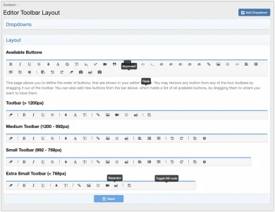

@katsulynx trying out the dropdown option, I can't seem to get any other font awesome icon to show up other than the little flag. is there some special formatting of the code to put in other than fa fa-...?
eye should suffice.Putting them there is unfortunately not possible.also, why can't we add text color, font family, and font size to a drop down?
Defining icons in Froala is an utterly complex process, and I haven't found out/tried yet, if it would even be possible to override existing definitions.lastly, is there a way to change which icon is used for the individual buttons? i'd like to change the spoiler from the flag. used to be able to do that under the old bbcode manager.
I've noticed that one as well, but I've considering it unimportant/annoying at most for the moment, and as it's only happening in the ACP. I've gone ahead and added it to the known bugs section for now.wanted to let you know about a possible bug, browser interaction - in google chrome desktop the tooltips are showing up and then not disappearing in the editor:
