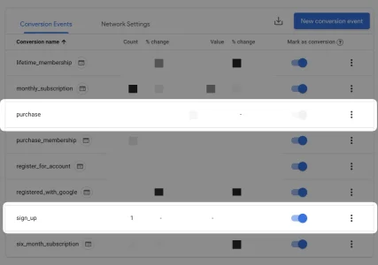

If you select a different event as a conversion just to test, do those show up? Just wondering if it’s an issue with just the sign_up event or their whole conversion report.
Purchase does seem to work fine. It's a greyed out switch on for "Mark as conversion" which I am not 100% sure why. Maybe it's the default? Either way, it seems to work fine with the report.
Admin -> Conversions shows:
purchase seems to have the correct number for count and value (blurred). sign_up does not.
To be clear, none of the others have the correct value (they're custom conversion events that I created from the ones I used to have on UA). Purchase works but that's it.

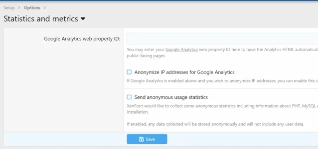

Should I leave this field blank?
It's not used if you are using the addon (the addon has it's own page of options). It doesn't hurt to put something there... but again, it's just not used one way or the other.

Does the Measurement ID supplied at the top of the Analytics admin page
/admin.php?options/groups/analytics/
make the Google Analytics web property ID supplied near the bottom of the SEO admin page
/admin.php?options/groups/seo/
redundant?
and if not, why does the property ID in Xenforo have a G- prefix?
Thanks

@digitalpoint our GA4 setup is working fine, but some clarification on the setup would be appreciated.
redundant?
Thanks
Ya, the default XenForo web property option isn’t used. So it’s not redundant so much as simply unused if you use this addon. There was some logic about why I didn’t reuse the setting that’s already in XenForo that you can see a couple posts back:
