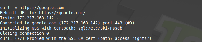

That's an SSL certificate issue with your server. Make sure curl is up to date on your server and/or make sure your SSL certificates are up to date (won't be specific to the addon beyond the fact that it needs to be able to communicate over HTTPS). Most likely will affect other things using HTTPS like image proxies, PayPal IPN verifications, etc.
CURLE_SSL_CACERT_BADFILE (77)
Problem with reading the SSL CA cert (path? access rights?)
Curl error 77 error is a server-side error. This error indicated that the chain certificate files are missing or “broken”. Usually, this error happens simply by outdated SSL certificate(s) for cURL installed on the server.
Thank you.
I haven't done anything on the server to cause those errors.
ssl certificate is valid I believe
# curl -V
curl 7.29.0 (x86_64-redhat-linux-gnu) libcurl/7.29.0 NSS/3.53.1 zlib/1.2.7 libidn/1.28 libssh2/1.8.0
Protocols: dict file ftp ftps gopher http https imap imaps ldap ldaps pop3 pop3s rtsp scp sftp smtp smtps telnet tftp
Features: AsynchDNS GSS-Negotiate IDN IPv6 Largefile NTLM NTLM_WB SSL libz unix-sockets
It's not the SSL certificate for your domain, it's the certificates that tell your server which SSL authorities to trust and how long to trust them (they need to be updated every once in awhile because the time to trust doesn't last forever). For example in my servers, they are in the /etc/ssl/certs folder. They might be somewhere else in your server. The certificates usually last a good amount of time so it could also be a permission issue (if PHP/curl can't read the certificates, it would be the same as them not existing).
Probably something to just ask your server admin about.
I'll check with @eva2000 to see if any of the recent update on his centminmod is related to this.
In the meantime, I see multiple instances of this error as well. I wonder if it's a related or different issue
