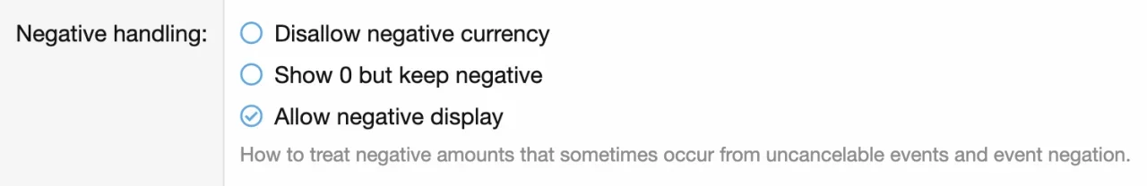

One more bug important than that, I upgraded to newer version, I don't want to people allow negative when they don't have enough money of currency, then it will prevent the event, not allow event trigger and negative to their account, please fix ASAP
This is not working, why no one report this BIG BUG?
No-one has reported it because there is no bug. You have configured your currency to allow users to go into the negatives.
Looks like your version is out of date then (or you're running the 2.1 version) since the phrasing is different. Regardless, I think you can find the "Negative handling" setting on that page :)
I think because the phrasing is different, I tried to set first option of negative handling and it's work again, and yes im running 2.1x
