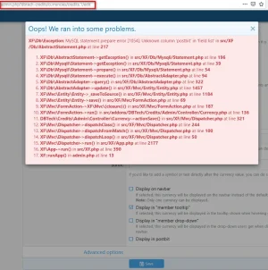

Save option server error log.
198703

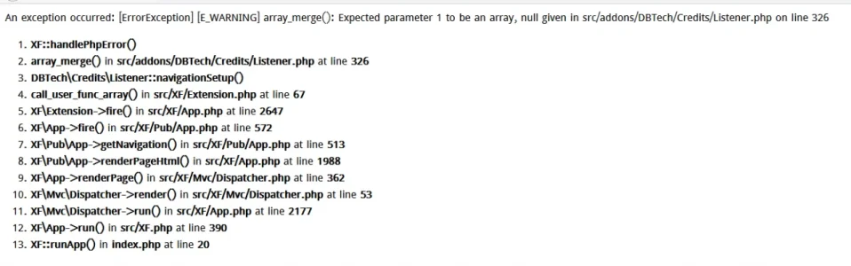

Also navtab are not working. Getting server log in homepage after enabled Credits permissions can View.
198712
Try running this:
SQL:
ALTER TABLE `xf_dbtech_credits_currency`
ADD `postbit` tinyint(3) unsigned NOT NULL DEFAULT 1
That looks like your addon cache is corrupt, try disabling and re-enabling any given addon to rebuild it.
What add-on need disabling and re-enabling?
All time getting There are manual rebuild jobs awaiting completion. Continue running them. but this are complete then still showing this message.
See here: https://giant.gfycat.com/WhoppingScrawnyCicada.webm
What about this issue?
This is the answer:
Line 326 in that file is $addOns = $container['addon.cache']; and if that's not the case on your end the files may not have been properly installed by the archive installer. If you were upgrading from v5.0 the addon needed to be disabled prior to upgrade.
Any.

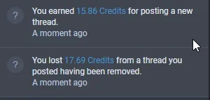

Some issues with this:
Editing a post sometimes triggers the post event, I receive an alert that credits were taken away (because of the negation amount I guess) and then another alert for earning them again.
Also, I have a View Thread event for $0.10 but it seems this plugin doesn't handle anything less than $1.00 - the transaction log says Earned 0 Credits
I'm not sure if there's a way to make it only display the first or last time in the transaction log, but I actually consider it a good thing that it modifies the award upon editing. In my case, I base the reward on amount of words, though, so I don't want someone pasting garbage, getting a load of points, and then editing to a normal post as if nothing happened.
Mostly replying because I know the answer to the last bit, though. If you go to AdminCP -> DragonByte Credits > Currencies, you can edit how far the currency displays with rounding. Default is 0 decimals, but if you do 2 decimals, it should display 0.00. In your example, the actual amount including partials should still be there even if they aren't visible. If Rounding is 0, a user with $1.40 will display $1. You can check by pulling up a user in ACP and looking at the DBTech Credits tab. In my case, I display whole numbers only, but I have actual numbers down to the hundredths. Couple of screenshots below.
Nice, now it shows earning $0.10 in transaction log.
So do I. A base of $2 per post with $0.005 extra for every character over 10.
I just think this is expected behavior, it should only be removing credit earned on post deletion. If I see a scenario like you've mentioned, I'll delete the post anyway.
Okay, now it happened again. Just edited a post and added about 20 characters.
This is problematic because I take away more than you earn if a post is deleted, so editing your post costs you credits.
