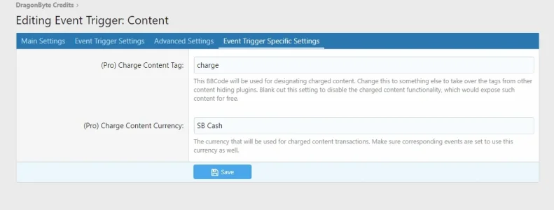

This is the screenshot for the Content event trigger:Screenshot_13.webp
Also, charge is selected from the Content Event, altough all price options are left to 0 so that, based on my knowledge I have of how it works, it will just deduct the amount the author of the hidden content will decide to charge people for.

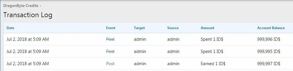

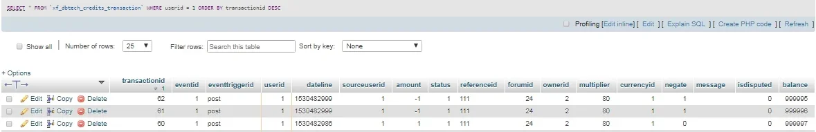

Hello, i have checked in xf_dbtech_credits_transaction, and the comparison between 2 rows are :
- same event id
- same dateline
Here i attach some images.
- same event id
- same dateline
If you PM me with an FTP and AdminCP account I can look into it further. Please also include the step-by-step instructions for how to replicate the issue.
