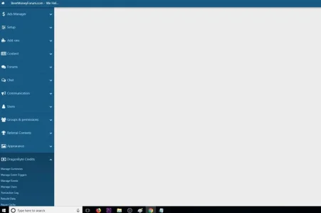

Hi @DragonByte Tech
While navigating to mysite.com/admin.php?dbtech-credits/ I get no statistics, this is after the previous instalation, today upgraded to last version and same, I was thinking it will be fixed but no. You there was some stats, sales of credits etc...
Other features working fine, no problem.
Is this normal? Or can be fixed? Thanks!
See attachments.

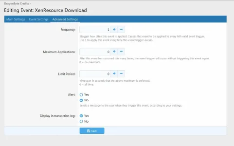

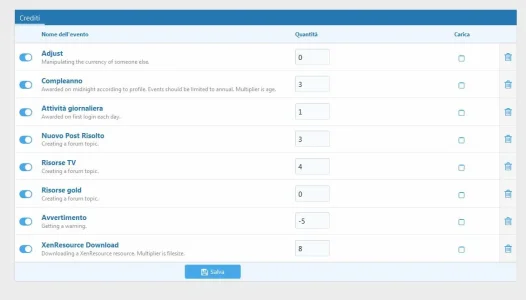

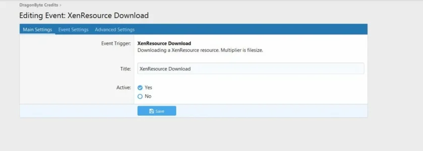

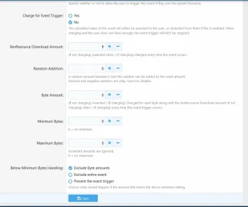

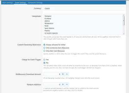

One of the most frequently requested features in the XenForo 2 version is integration with the Resource Manager. We are very happy for this upgrade but there are problems. Maybe we're wrong in the settings
When a user uploads a file in the resource section, credits are assigned to him. ok? (this works). if a user downloads a resource, the credits are not deducted.
I show you some settings.
Sbenny
@UMILE you have to set "Charge" and the usergroups you want the event to apply to. If you don't specify which group should pay the amount (altought you set it as reward and not charge at the moment), the event will never trigger.
