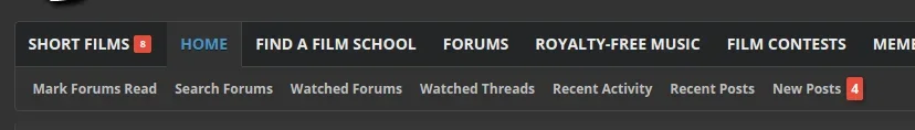

Hmmm... for some reason this update moved my home tab here instead of the far left... try to figure out why....
Nothing has changed with regards to the code for the Home tab.
Which add-on is providing the Short Films tab?

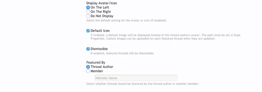

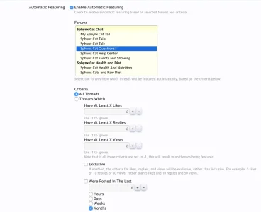

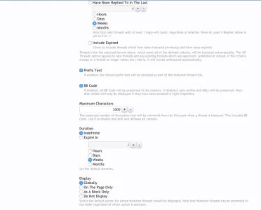

So I attempted to try the "automatic" featured thread and still can't seem to get it to work, here are my settings, am I doing something wrong?

What isn't happening that you expect to happen?

When choosing the auto feature, nothing is featured, just my manual featured threads I chose to feature that have been there for quite sometime. Do I have to somehow turn off the manual feature perhaps?

Are they existing threads or new threads which you are expecting to be featured automatically?

As the description text states:
The 'All Threads' option applies to new threads and any existing threads which are approved, undeleted or moved.
You have to use the likes/replies/views criteria option for existing threads.

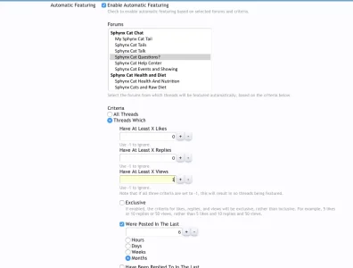

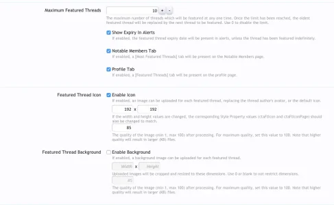

This gives me zero results, are there setting elsewhere I am missing for existing threads?
