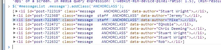

Here's an example I've just executed on this page using the browser console:
But in terms of adding styling to that, I'm not sure how useful that would be. Those elements are the list elements which are the posts on the page. They are also the anchor links. Manipulating the styling of those would also manipulate the style of posts.
