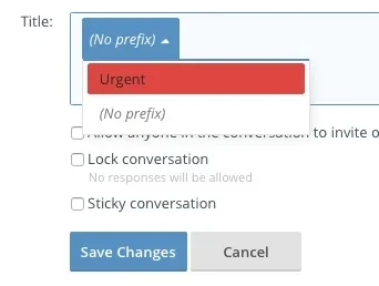

Xon updated Conversation Essentials with a new update entry:
1.12.12 - Bugfix update
  • Split bulk template modification code for Filters into the template convess_conversation_list_filter
    • fix filter links now showing up as expected.
  • Fix installer when upgrading from pre-1.12.8
Know compatibility issue:
  • UI.X & setting a conversation prefix results in the prefix appearing behind the popup.
    • Installing Multi Prefix "fixes" this by replacing the prefix...
@Jake B. fyi, there is a compatibility issue with UI.X & this addon's conversation prefix UI.
In uix.css;
.Menu { z-index: 9000;}
XenForo standard title_prefix_edit.css has:
.PrefixMenu
 z-index: 15000;
Due to CSS ordering, .Menu has preference over .PrefixMenu
Overlays gets a z-index of 10000, which is why .PrefixMenu is getting pushed the overlay.
@Xon Could you elaborate what exactly that means...
