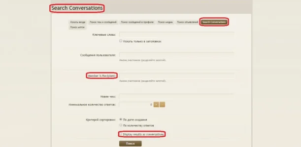

Pls adv phrases names responsible for values in red boxes:
I have to translate them but cannot find them...
