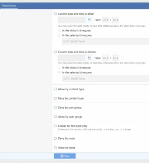

Is it possible to configure reactions for each node?
For example, in node 1 only reactions A and B can be used, in node 2 reactions C and D, and in node 3 reactions A and D.
Thx
Thx
This add-on allows restricting reactions to be usable or not usable by forum:
After upgrading to XF 2.2 and Content Ratings 2.5.3 / Content Ratings XFRM 2.1.0 -- When a user selects a reaction (clicks the 'thumbs up' for example) the reaction bar disappears. It does not reappear with the updated count until the page is reloaded. Is this intended behavior, or do I possibly have a conflict somewhere?
Hi Xon!
I just bought the addon and would have a suggestion for future updates.
In the same way that you can exclude reactions on the first post, it would be nice to be able to have reactions that could only be used with the first post and no the rest. With my forum, for example, I use the first posts to identify books and the replies as user comments about those books. I wanted to use reactions that could only be used with books (first publications)
