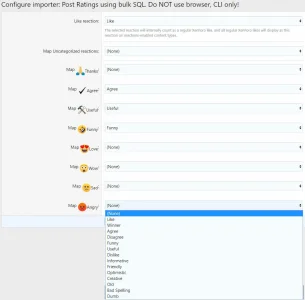

I have Content Ratings version 2.0.5 installed on our sandbox.
I need to do a test run on the bulk sql importer from the Post Ratings system.
There are 2,802,440 rows in the dark_postrating table.

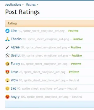

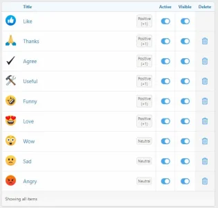

The XF1 ratings have been set up to use the following ratings:
The sandbox has been set up to mirror this:
However, when I come to run the bulk SQL import, 5 out of the 8 existing reactions are not given as options in the drop-down list
What do I do, please?
@Stuart Wright it looks like it has been confused on the naming of the old reactions (Post Reactions has some bugs I think in how the names where stored). I may need to push a version which adds some more context so you can tell when the phrased name doesn't match the hard coded name which is sometime used.
Additionally; the importer will create un-mapped reaction definitions so existing reactions are not lost but the reaction name may be left weird

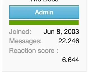

And how do I remove the numbers but leave the bar? I can only seem to have neither or both.
I want to keep the bar but remove the "reaction score".
There should be an option under the "message postbit" style properties to disable the reaction score. Otherwise I'll need to find some time to kick it a bit

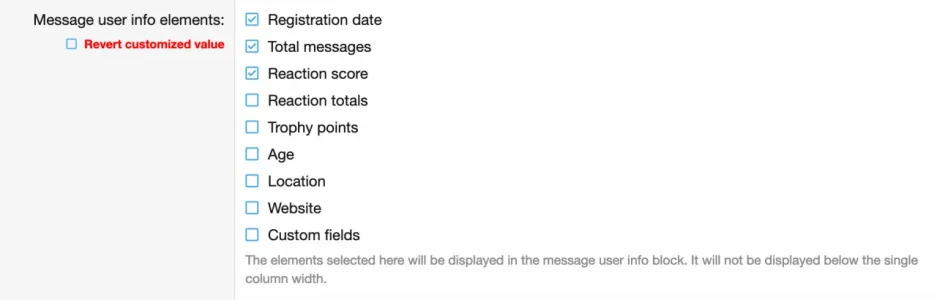

Message user info elements has this:

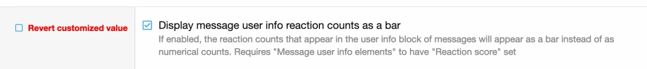

If I untick Reaction Scores it doesn't show the bar either. That's consistent with the description:
but it shows both the score text and the bar as I posted above. I just wanted the bar to be shown and I don't think that currently works?
Will need to look into that then

Showing the reaction bar without the reaction score isn't working atm.

Next version will decouple "Display message user info reaction counts as a bar" style property from requiring "Message user info elements" to have "Reaction score" set. Just chasing down some other to-do items before it can be released
