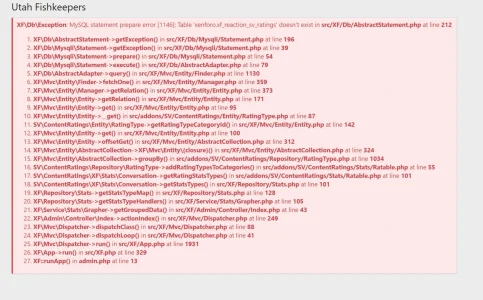

I just updated to Content Rating 1.3.7, and it broke the main page of the admin CP after I uploaded the files, and after I ran the upgrade, the main error went away, but now there are a bunch of logged server errors:
188974
188975
The stats error is not unexpected. Can you post one of each of the post macro ones?
Otherwise you can clear your error log and see if it happens in the future, upgrading can always cause things like that

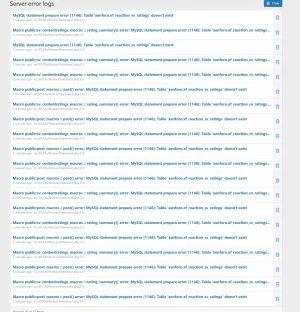

Here is one of the macro ones
Server error log
  • XF\Db\Exception: Macro public:sv_contentratings_macros :: rating_summary() error: MySQL statement prepare error [1146]: Table 'xenforo.xf_reaction_sv_ratings' doesn't exist
  • src/XF/Db/AbstractStatement.php:212
  • Generated by: CarpCharacin
  • Nov 24, 2018 at 10:28 PM
Stack trace
SELECT xf_reaction_sv_ratings.*
FROM xf_reaction_sv_ratings
WHERE (`xf_reaction_sv_ratings`.`reaction_id` = 2)
LIMIT 1

#16 src/XF/Mvc/Dispatcher.php(41): XF\Mvc\Dispatcher->dispatchLoop(Object(XF\Mvc\RouteMatch))
#17 src/XF/App.php(1931): XF\Mvc\Dispatcher->run()
#18 src/XF.php(329): XF\App->run()
#19 index.php(13): XF::runApp('XF\\Pub\\App')
#20 {main}
Request state
array(4) {
["url"] => string(26) "/showcase/comments/24/like"
["referrer"] => string(76) "https://www.utahfishkeepers.us/showcase/downstairs-bottom-40-gallon-tank.20/"
["_GET"] => array(1) {
["/showcase/comments/24/like"] => string(0) ""
["_POST"] => array(4) {
["_xfRequestUri"] => string(46) "/showcase/downstairs-bottom-40-gallon-tank.20/"
["_xfToken"] => string(8) "****"
What are showcase comment likes?
