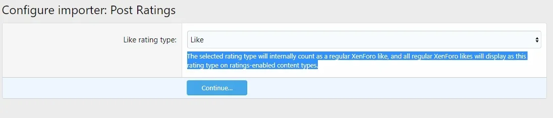

Can you expand on what this highlighted text means? Should I leave it blank? I have a rating I setup called "Like" but I don't think it was associated with the original forum Like... can't recall. If I select Like, would that be fine, even though it was a custom rating I setup?
You need to select a rating type to be a wrapper for the XenForo Like. It will replace the initial "like" rating type created by this add-on.
This should be whatever rating you want to keep if you uninstall this add-on.

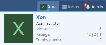

It does at the ratings show on the visitor card;
I guess you would be using a theme which adds the current user + mini summary to the page like in XF1?
Yes I am using that widget yes. But interestingly enough I tried the way like in your screenshot and clicked on my username and it still only showed likes. Is there a setting I need to enable to get the ratings to display in either place?
Also to add to this I just checked on the default style and it displayed ratings properly in the way you showed in your screenshot and in the actual visitor panel widget. I'm hoping you have some way to help with this since UI.X is a very popular theme. I'm currently using Xenith
