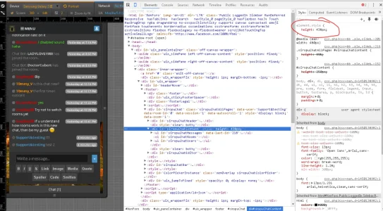

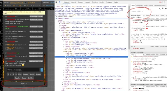

Bug
On the All pages view mode:
- Use the website on a small screen, i.e. Samsung phone
- Open the chat. Works normal.
- Write something and submit = works normal*
- Close the chat and reopen it = problem. Parts of the content becomes below the editor.
*Not always. On my actual mobile, when the keyboard shows up, the issue happens.
@Siropu Please check this bug
He is already on it :)
He made a fix that works on the phone emulator on PC browsers, but he needs to test it on an actual phone, because a 480x800 on a Samsung Galaxy S2 is not the same size on the emulator. They have different ppi
Also a phone browser has other factors that makes this issue even worse; the header while scrolling up and the keyboard

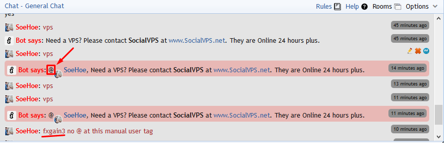

Need some options please:
1. @ sign at Bot response, please remove it or add an option to exclude it.
2. No avatar in front of username when tagging. can you please add an option for it?
Thanks
@Siropu
Chat ignore no longer works. They get added to the ignore list in user preferences, but ultimately messages are not ignored in chat.
@SoeHoe, the avatar in user tagging is not a default XF option. You can use css to hide it if you know the class used.
