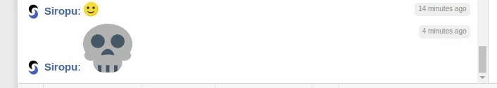

Alignment problem with large smilies:
Fix:
Step 1:
.siropuChatMessages>li>div - remove vertical-align: top;
Step 2: .siropuChatMessageContentRight - add vertical-align: top;
Fillip
That's strange because I can't reproduce it. There is an issue with avatar alignment but I have fixed that for the next release.

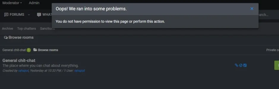

Hi! I've installed the chat and looks good, but I get this message when trying to edit a room:
I'm the board administrator, global moderator and I have all the relevant permissions in the Moderator Section and Chat Section Options. Am I missing anyting?
Edit: Forget about it, my bad. I was missing some of the permissions. Everything's working ok now.
