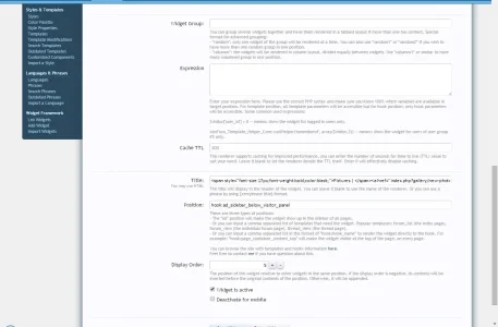

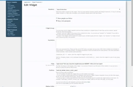

Okay, here is some shots of two widgets. One for on-line users, and the other for recent pictures (I use snoob's gallery).
Those screenshots show those widgets using the hook position. Remove that and put forum_list in there instead. Do this for all widgets and it should work.
