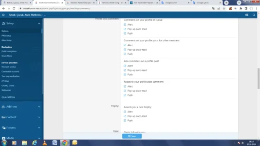

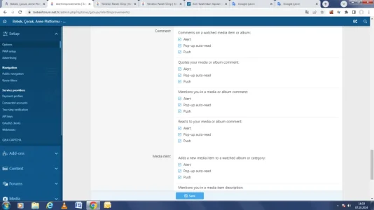

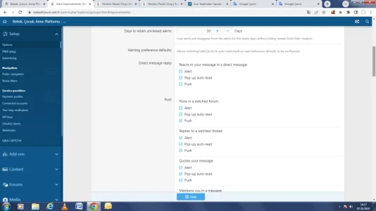

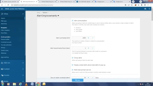

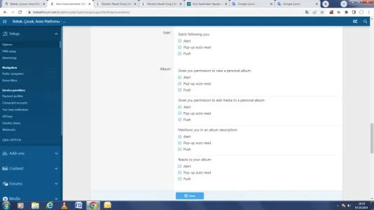

Hey @Xon,
Suppose I have 20 unread alerts—some are mentions, some are likes, and some are comments. When I click on the bell icon, all alerts are marked as read.
I believe the "Mark-read prompt opt-out" option is meant to prevent this, but by default, "Prompt on bulk mark read" is selected at the user level. As a result, many members who are unaware of this setting are facing issues. The majority of members prefer to keep their unread notifications as unread until they manually open them.
Look at the Alerting preference defaults option. This allows configuring Pop-up auto-read per-alert and also if they have an alert opt-out enabled by default.
You can also configure new-user defaults in the Default registration values option for the per-user "Alerts page options" and "Alert pop-up options" configurables
