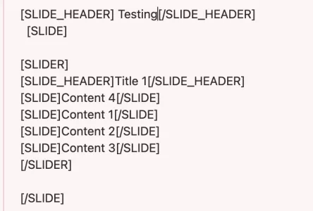

One of our members has recently reported that she cannot get the [SLIDER] tag to work properly when it is inside [SLIDE] tags.
Here's what the code looks like:

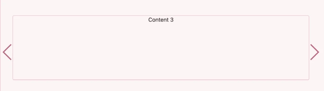

But when saving the changes, it ends up with just the last slide showing (in this case, Content 3), with no way of getting to the other content (arrows don't work):

I strongly recommend using raw bb-code mode, and ensuring there isn't any invisible formatting; as nested sliders do work.

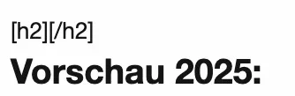

• also, sometimes headlines are not displayed as headlines in WYSIWYG mode but with the headline tags, looks like this (this is the WYSIWYG editor and before installing this plugin the headlines were displayed as headlines):

• sometimes additional headline tags (that were not there before) are added above existing headlines and displayed in the saved post as raw BB code, which clearly should not be the case. Looks like that:
(this is NOT in edit mode but the published post view)

I really need samples of the html you are copy & pasting, and the raw bb-code that is causing editor issues.
Screenshots just don't carry enough information to reliably reproduce all editor issues
To get the raw bb-code/html;
  • Edit the post in question, switch to bb-code mode, and then refresh the page and edit the post again. This will load the raw-bb-code without trying to convert it to html => bbcode
  • Use the "editor playground" (Account Details => Editor playground, or /account/editor-playground). And check "Show raw copy and paste output", then copy & paste the problematic text into it. Then copy the raw html it outputs.
I'ld recommend opening a ticket, and attaching the requested information. This will take a little debugging as I'll also need to know which bb-codes are active and any other 3rd party addons.
