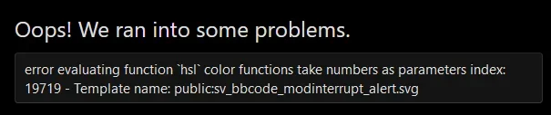

I followed the 'involved' process but still have CSS errors after rebuilding. Namely, I can't post any replies anywhere, as the reply box now has no text area to type in. When I disable the updated add-on, everything is back to normal. o_O
Please ensure you've updated my SVG Template and StandardLib add-ons, then try doing a rebuild of the advanced bb-codes pack add-on.
StandardLib was updated first. I don't use SVG Template - will that affect the BB-Codes addon? I'm also thinking of completely uninstalling the bb-codes add-on and doing a fresh install, maybe that would help?
No, that shouldn't be an issue.
This will reset the styling properties and other options but otherwise will not damage user content.
Can you open a ticket on my add-on site? I would need access to your site (via ssh) to interact with the XF CLI to attempt to resolve this.
This add-on should cleanly update, and that it doesn't is worrying and something I will need to fix.
