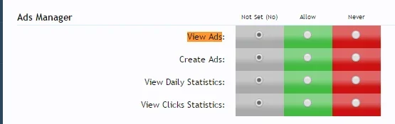

I cannot get the ads to show public?
The Javascript is changing the ads really fast... I tried raising the timer didn't do anything... I would rather they didn't switch at all mainly rotate as the page loads...
You have to set permissions first. Set "View Ads" for Registered and Unregistered / Unconfirmed groups.

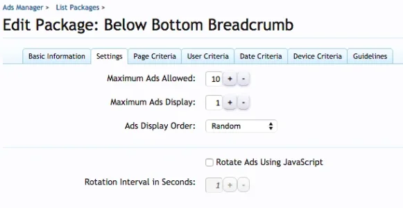

You have to set "Rotation Interval in Seconds" in package settings to 5 seconds or higher.
Try this, then they rotate on page load. :)
