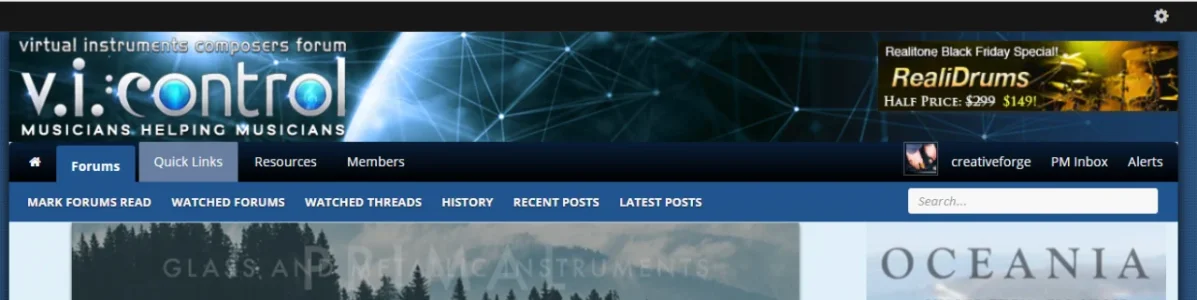

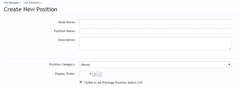

You wrote: "You can add custom positions if you want, so if you need help, just open a support ticket." And I'm trying to create a custom position for ads to display in the header here on the right: RealiDrums.
How do I create a custom position for it, I don't understand the values I need to enter?
Thanks you anyone for any help!
For now, all I need is to be able to understand the process of creating a new position.
1- Am I correct that a new position requires to create a new hook too?
2- How do I create a new hook?
3- Ho do I connect the new hook to new position?
4- How does Xenforo recognize this position, where do I edit the template to insert a new position?

You just need to create a new position in the Ad Manager and then insert that position to the template where you want the ad to be displayed. You should have a basic understanding about the template editing before doing this. If you insert the position marker correctly, it will be called with the template when it loads.
1. From ad manager, Positions > Create New Position
From here, you'll create the hook name (which is used in the template) which can be anything you want to identify the hook/location.
The rest of the settings are up to you depending how you have your ad system organized. The most important thing here is the hook name, position name and a description to help you remember the details later. Position Category is up to you based on how/where the ad will show. Categories can be customized from "List Positions".
2. Once you have created the Hook from #1 above, you can then insert that hook to whichever template you need it in. If you need to create a new template to called in XenForo, that's a whole other ball of wax. You'll want to setup the new template first and then insert the new ad hook once it's created. (Use the Xenforo template manager under "Appearance" to find/edit/create templates as necessary. You should have a basic working knowledge of the Xenforo template system to complete this part.)
3. Again, the hook is automatically called (if it's inserted correct) and the ad is displayed assuming the criteria is met for the viewer.
That's the simple version, hope it helps get you started. Others can chime in with other details to help fill-in the gaps as necessary. (or ad examples)
One Example:
- I created a sidebar ad with the hook name: ad_sidebar_one
- I inserted than in the sidebar template I already created with the following code:
<xen:hook name="ad_sidebar_one" />

Thanks! I tried for an hour or so but gave up. And then I realized that the position HEADER was NOT enabled. But how am I to understand all of this? It drives me nuts how developers don't take seriously the difficulty for newbies to use their product for the first time. It's unfamiliar territory, and a map would be very useful.
A tutorial. I would PAY for it!
That position already exists: "Header".
Hi, yes, but that doesn't mean anything to me if you do not provide a context. Do you understand why I didn't notice the position "Header?" Because it is UNCATEGORIZED by default.

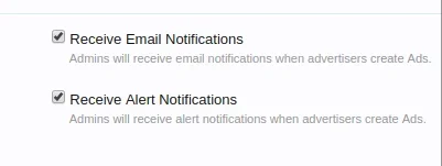

When a user creates a new advertisement, admin does not get a "forum alert" & "email alert"
any idea how to do testing?
ads manager: 1.26.3
xenforo: 1.5.13
if admin reject or approve advertisement, the user will receive "forum alert" & "email alert"
only for admin it is not working

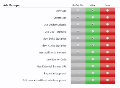

We have been having issues with members not seeing ads anymore, they only see ads when they LOGOUT. They used to see them, but not anymore.
Am I setting this right? We do not allow members to create ads yet. So this is disabled. Could you check to see if I'm messing things up here?4a8e7c5331a97431ef265fef0b9b51e9.webp
What are the ad criteria settings? You may have a conflict in your ad packages where you specify who should see the ad. If they can see ads after logout, it's possible that you have an exclusion for members or possible set only to display to guests. Just a guess...
