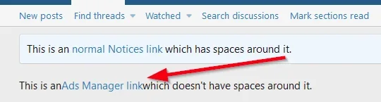

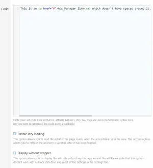

For some reason, spaces to the left and right of text links in code ads are removed. Any idea why this might be, and how I can fix it?
Default style, default ad settings, no package selected:
For now you can fix it by adding   before and after it.
Ok, that's what I've been doing (or adding padding via CSS). It's just a pain having to go through and fix them all when someone other than myself creates one. Odd that the other links don't behave that way.

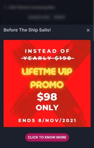

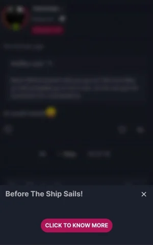

@Siropu , I've been using your ads manager for some time now. It has come to my attention from my users that when they are scrolling a page, the banner image that I used for my popup ad doesn't show for them.
My popup has a delay of 5 secs before being displayed to users.
This is my popup ad content:
<div class="my-ad-block"><img src="https://abc.com/210Promo.png" alt="210 Promo"></div> <div class="my-ad-block"><button class="button button--primary"><a href="/pages/210promo/">Click to know more</a></button></div> <div class="my-ad-block"></div>
I have attached screenshots showing what my users see when the page is not moving vs when they are in the midst of scrolling.
Kindly let me know if this is a known bug. Thanks!
Edit: After many more rounds of testing, it seems that using delay is the problem. When there is no delay set, the banner image displays without fail.
