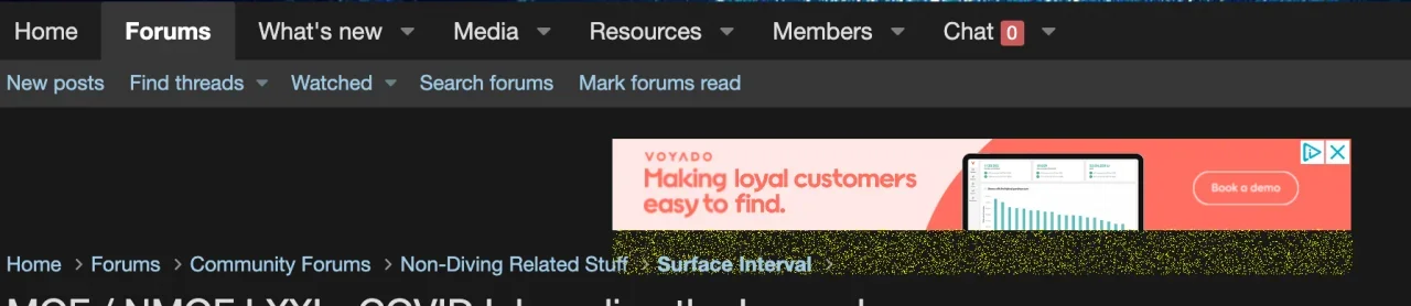

In the screenshot above, it seems like the area for the advertisement disables the hyperlinks of the forum-navigation-links below the ad (the yellow shaded area).
How can I add padding below the advertisement area?
Put it in a DIV like this:
<div style="padding:20px;">
or
<div style="padding:20px 20px 20px 20px;">
where the order of padding is top, right, bottom, and left (clockwise from top)
or
<div style="padding-bottom:20px;">
