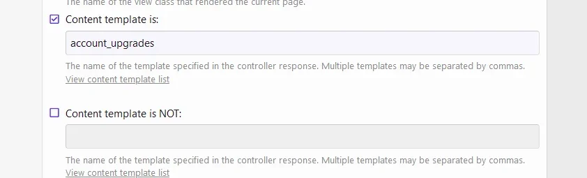

Hmmm, above content ads display on the "account upgrades" page even though I have "Content template is NOT:" set to account_upgrades and I am not Inheriting any package settings.
Any ideas?

I do the opposite, actually. I have a special banner that only displays on that page.
You could probably do the opposite, and put it in the second field in this image.
content template is NOT: account_upgrades (in page criterial tab)
I just tried it, and it worked fine. You can do it within the PACKAGE, so it will apply to all banners in that package.
I wonder if there is a limit to how many templates you can exclude as I had the following and it didn't work.

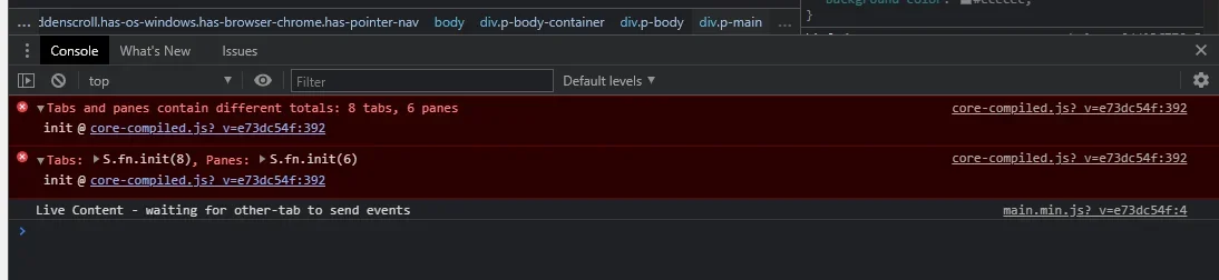

Got a strange issue when using a different language pack.
Editing an ad isn't possible, and the above error is in Chrome console:
