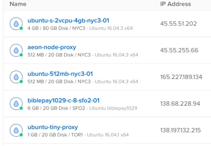

Nope. I would be more than happy to give you the login details to my Linode, Digital Ocean and OVH accounts where those do exists.

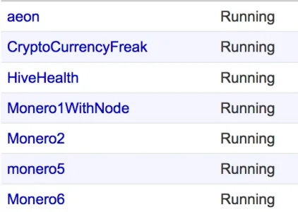

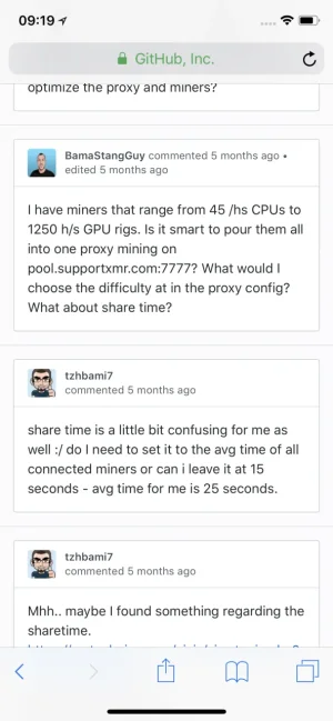

As well as my 6 GPU and other mining rigs I have at my house. That is what is mentioned within your screenshot. Again, I am sorry that your server was left with that running but I am being nothing but honest with you right now. It was not meant to be and it was a very bad judgement call for me to ever have been testing it on your server without asking you in the first place.
