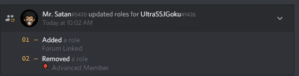

Like to report a bug though.

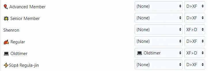

Set it up so these 2 roles from discord, will be applied to their forum profile as well. And while that works perfectly fine:
Their roles are being erased from discord at the same time:
Is this intended? As I assume the sync would be to sync the roles they have from discord to Xenforo without erasing their discord roles at the same time.

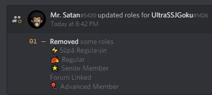

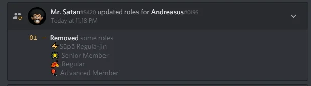

EDIT:
Even setting the settings to "no" (while leaving D>XF tagged), the bot will still erase the discord roles.
See:
and:

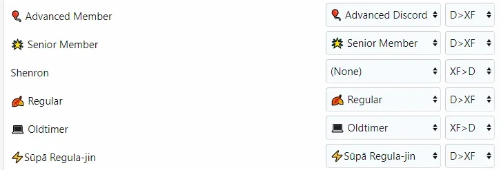

I've added that part of the code above
if (!empty($groupChange))
(123)
And it still appears to be erasing roles from discord:
The forum linked role is a XF>D setting, rather than D>XF case you were wondering.
