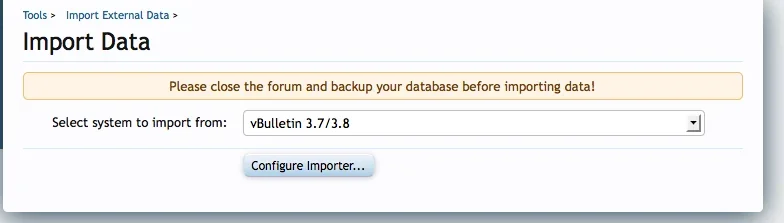

why does the importer says 3.7/3.8? I'm running vb4.0.6

This is the 3.7/3.8 Importer, not the vBulletin 4 importer.
You are not running the correct Importer, hence it crashes.
You have to download the vB 4 importer from the first post of this thread, unzip it and upload it to /library/XenForo/Importer. Then vB 4 shows up as an option.
Oops, sorry I was certain that I had the importer inside the right directory, but I was putting it in/library/XenForo instead of /library/XenForo/Importer
tsc.. tsc.. Thanks guys!
