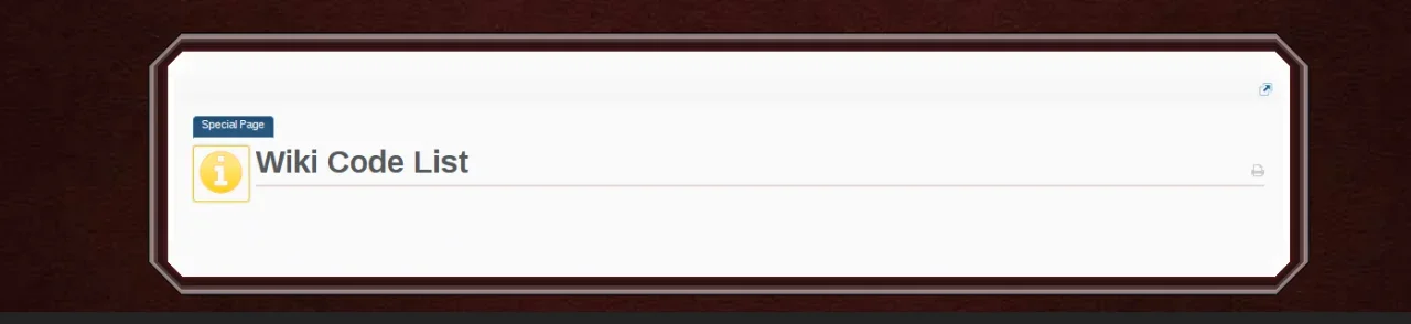

Do you have new BbCodes in XenForo's BbCode Manager? From the attachment you posted, it looks like the phrases for WikiCodeList are missing. Perhaps the Rebuilding Caches step at the end didnt run or didn't finish yet.

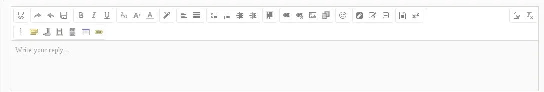

Vault Wiki BbCodes show in reply box (Note this reply box is in a thread not associated with vault wiki)

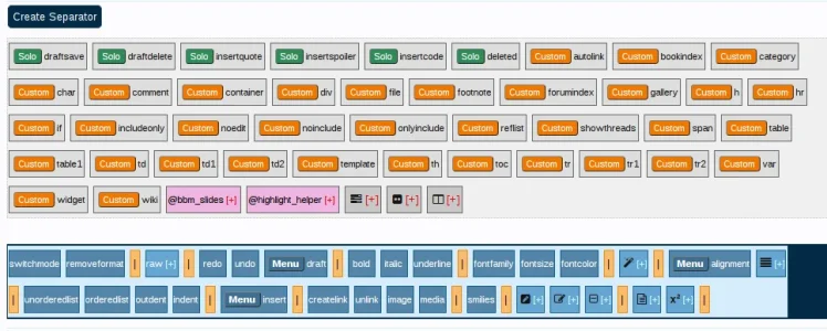

However, in the Buttons Manager it is not activated. I tried going through all options in acp and other areas to try and fix this but can't seem to figure it out.

It looks like a bug in VaultWiki. Custom BB-Codes, including VaultWiki BB-Codes, will appear in the Quick Reply box in default XenForo, from what I understand (another test BB-Code I made appears). In any case, the Wiki-Related "Show in editor" option will take precedence over whether it is activated or not in the buttons manager, and buttons flagged as wiki-related will use the VaultWiki grouping instead of the buttons manager grouping. This is expected. However, it seems like unchecking the "Show in non-wiki editor" option in the BB-Code manager has no effect. I can duplicate this behavior on my test board so I don't think it's related to the other add-on.
For now, a temporary solution would be to blank the editor icon fields for the BB-Codes that are showing, but this will make them disappear from the toolbar in the wiki too, and you would have to remember to set the fields back after a fix is posted.
To fix "Show in wiki/non-wiki editor" not having any effect, edit library/vw/XenForo/ViewPublic/Helper/Editor.php. Find:

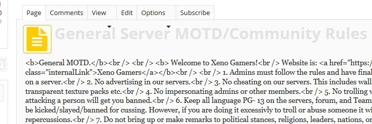

However, my pages are being rendered in raw HTML, and I'm not sure why.

For the parsing, have you tried clearing the cache: Wiki CP > Maintenance > Rebuild Counters / Caches > Cache Parsed Content? I cannot reproduce this problem either on the newest version (it was a bug in a really old version; maybe it was saved in cache that way).

It fixes it for the first page load, then reverts back to the screenshot :(
I would recommend that you open a ticket request at the support site in the Members area, under Services. There is either a bug here that I can't reproduce or you have mixed file versions on your server which is not safe.
There is a conflict with an add-on you have called "GreenText." It looks like it is designed to double-encode HTML in various situations (once in the parent, then again in itself); I don't really understand that. I have modified the execution order of VaultWiki so that VaultWiki occurs later in the chain and can have the final say on what gets encoded.
