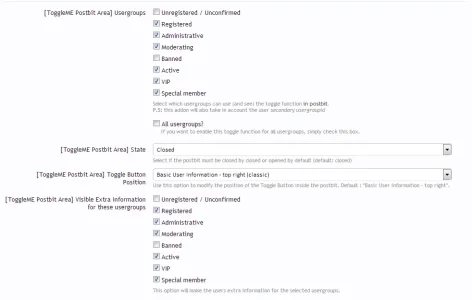

I do exactly like you said. Chek screenshot.
Untitled.webp But, guests can see postbit fields and for admins toggle button opened.
@Sasa
It works as expected.
1) ToggleMe is not enabled for the unregistered visitor, so it's kind of normal that it doesn't work
2) You set the default postbit state to "close" BUT you force it to be visible for the "Registered, administrative, moderating, active, VIP and Special member". I will rephrase the last option that is unclear and where an adjective is missing in the description.
