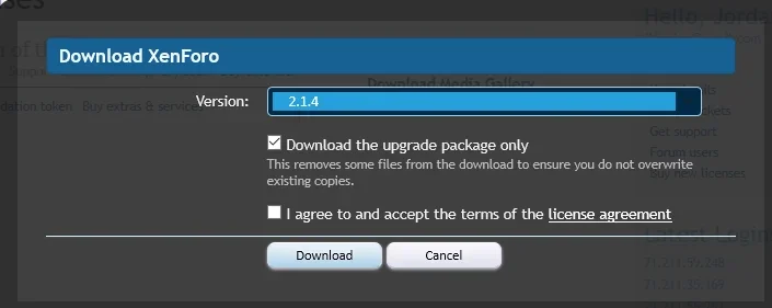

Hey Chris, it seems we just ran into this ourselves on our forum after doing an upgrade from 1.5.7 to 2.1.4. I didn't realize the install files were tied to the license itself (we have two sites running Xenforo.) So if we download -just- the upgrade package for the 2.1.4 using the correct license:
What directory do we upload those files to? Just overwrite everything? And once that's done, then it should correctly point to the paid license associated with the download files, correct?

You need to ensure that the license has the correct URL associated with it and to only use the license files on that site.
If you have multiple licenses you can't use the same files for every site, or use the files for one site on another and vice versa.
