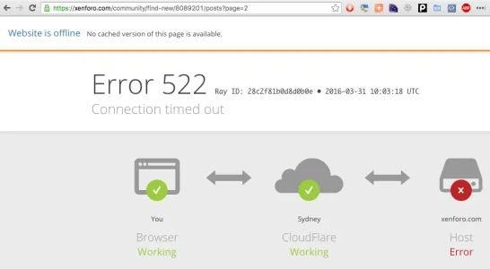

Even xenforo.com cannot get Cloudflare working correctly for them, with it giving errors and timeouts all the time.

I agree, I also see those Cloudflare error almost every day here on this forum. (Australia)

Interesting... never seen that for this site, and I'm in Melbourne, so pretty much going out of Sydney also.
Sydney is another pop, Seen errors when I was in Melbourne too a month ago.
Mike is working with Cloudflare to fix it so hopefully it will be fixed soon. :)
