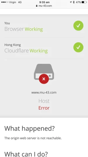

Yesterday I was having problems with visitors from Australia getting messages like this one:
I switched off from Cloudflare Pro back to having DNSMadeEasy handle DNS and KeyCDN handle attachments. So far, the feedback has been that the site performance is much better with these changes. See our forum thread beginning with this post: https://www.mu-43.com/threads/is-it-just-me-or-is-the-forum-really-slow-to-load-lately.89001/page-3#post-985298
It's disappointing because Cloudflare is the only way I know of to show full attachments to members via CDN while keeping attachment permissions intact so that guests see thumbnails (makes pages extra speedy for guests + Google). However, lazy loading images mostly makes up for that.

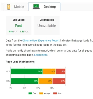

3) Google now makes available their Chrome Experience Report data on a site-wide basis. This is basically Google's overall estimation of your site speed based on "real user measurement of key user experience metrics across the public web, aggregated from users who have opted-in to syncing their browsing history, have not set up a Sync passphrase, and have usage statistic reporting enabled."
This info is only available for relatively popular sites, where Google has enough data to give a report. Google uses site speed as a ranking signal for desktop search and is about to start using it for mobile search, so this seems like a good tool to understand your current site performance.
To check your site, go to this page: https://developers.google.com/speed/pagespeed/insights/
And then enter "site:yourdomain", eg "site:https://www.mu-43.com" and click "Analyze."

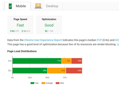

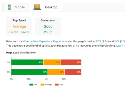

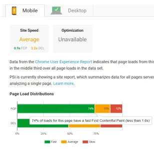

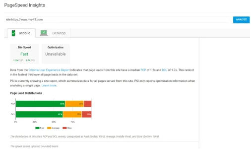

Here's how one of my sites looks (I expect these numbers to improve given the changes mentioned above):
rdn
Mine with Cloudflare Pro Plan.
No guest full page caching as I have complicated ad serving for Desktop vs Mobile.
Amin Sabet
It looks like you're showing page results there rather than site results, no?
I should look at mine more closely, because I have complicated ad serving for desktop vs mobile as well, not to mention Europe vs non-Europe.

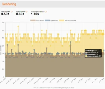

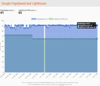

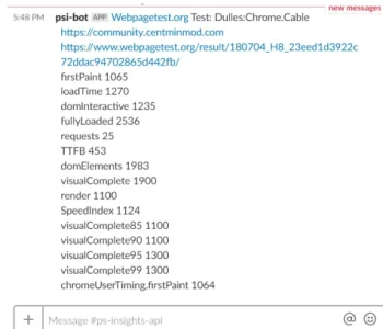

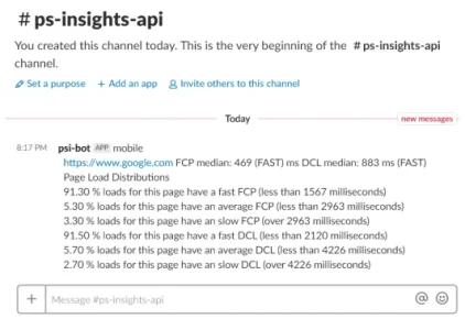

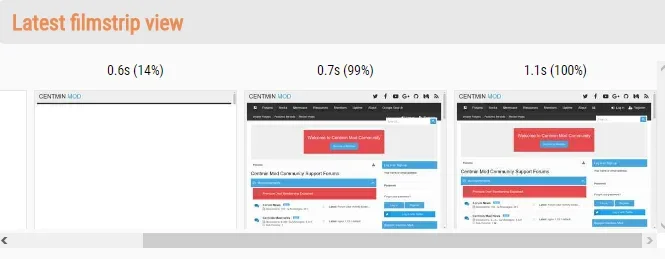

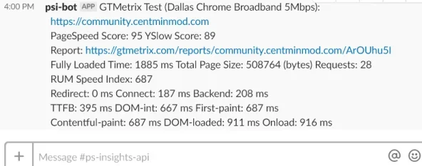

@Amin Sabet @rdn as a fellow page speed addict you might want to check out a new script I whipped up to use APIs for Google PageSpeed Insights, GTMetrix and Webpagetest.org to run via command line pagespeed tests and optionally send the results to custom Slack channels. I even setup a cronjob to run the test every week and send results to my Slack Channel :D
https://github.com/centminmod/google-insights-api-tools
Slack channel results
WebpageTest.org
GTMetrix
enjoy :D

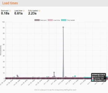

I am constantly optimising and trying new optimisation techniques and technologies (DNS,CDN,web/php caching/ngx_pagespeed etc) on my sites for performance and scalability and only way to monitor progress is to test it. Otherwise I'd be flying blind :)
My addiction and 4+ yrs of page speed testing work logged at https://community.centminmod.com/threads/community-centminmod-com-journey-for-speed.3/:D
Privately, I also do hourly WebpageTest.org tests which i log and chart too. I do this because this is what I do for a living = I do server and site optimisation consults and web host/server recommendation/evaluation work for clients since 2002 (16+. yrs).
This is just for WebPageTest.org California region test results. I test up to 12 geographic locations which are the top locations for my Google Analytics and Piwik analytics reports.

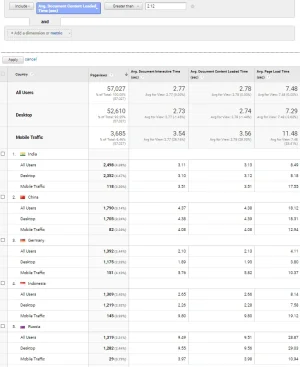

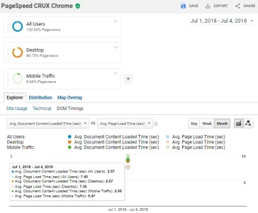

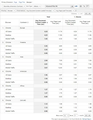

Also for PageSpeed Insight origin stats you can use Google Analytics to filter data by Chrome browser for avg document loaded times (DCLs)
and then figure out which countries in your GA stats are negatively affecting your DCL numbers which from Google PageSpeed means <1366ms and <2120ms respectively for desktop and mobile for DCL to be considered as FAST rating in Google PageSpeed Insights origin tests
So for these GA stats, top 5 countries which negatively affecting a fast rating for DCL are India, China, Germany, Indonesia and Russia !
