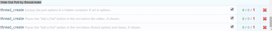

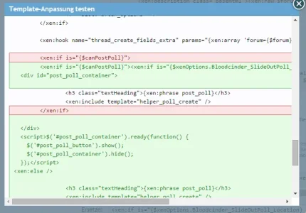

Hi, the addon doesn't work. I've got Xenforo 1.4.4 and under the template chges there are red numbers:
that is the error:
sbj
See:
The issue was discussed privately. I determined that Edit Post Date by Waindigo was causing a template modification compilation error for several different add-ons, and that Poll Permissions by AndyB is incompatible with my add-on. With both of those disabled, Slide Out Poll works correctly.
I do not know what the problem is with Waindigo's add-on, but I don't have any intentions of making a compatibility fix for AndyB's add-on. However, I think the application order for the template modifications can be changed so that my add-on goes first and AndyB's goes second and then they don't conflict. I'm not sure.

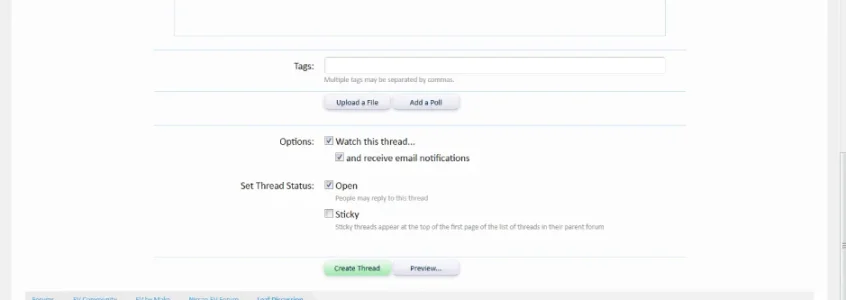

For the issue of duplicate "create thread button" and I understand having 2 is confusing and unprofessional, while having nothing at very bottom isn't good either, what about removing "create thread" button from first row and placing it in second. Then you will always have it at bottom, whether poll or not, and not have a duplicate? The same with "preview" too. And putting cancel poll at very bottom if poll is selected.
There's no reason to have the create thread button above further options like "watch this thread" etc
This would be very smooth... no? :cool:

Ok well I changed "thread_create" template to do this:
From:
<dl class="ctrlUnit submitUnit">
        <dt></dt>
        <dd>
            <input type="submit" value="{xen:phrase create_thread}" accesskey="s" class="button primary" />
            <xen:include template="attachment_upload_button" />
<input type="button" value="{xen:phrase preview}..." class="button PreviewButton JsOnly" />
Changed to:
        <dt></dt>
        <dd>
Nice and clean for those new ppl like me:
Just wish the "cancel poll" (when poll is selected) would be at bottom but keeping "add poll" at top, but this is still nice.
Does anyone see any problems with removing those 2 lines?
