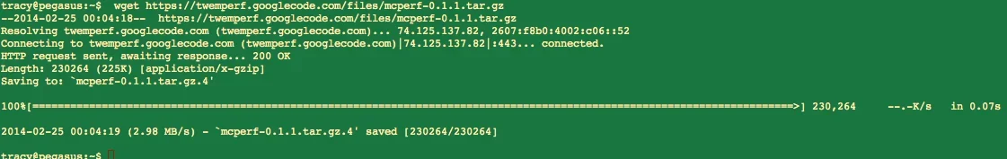

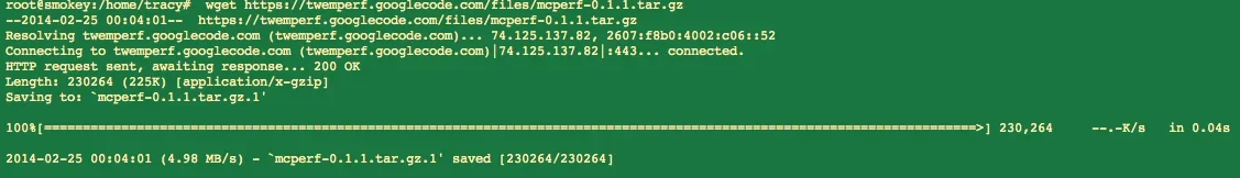

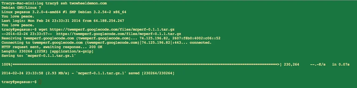

OK... I'm still leaning towards a config error because I was able to get all 3 to work just fine. All I did on the second one was edit my /etc/hosts and removed some domains that were not being used any more and rebooted the server (but don't really see where that would effect it). I also made sure my /etc/network/interfaces were similar in all of them and my /etc/resolv.conf contained the primary server domain name in it. If you notice, each is a different server.
EDIT:
My alpha.twowheeldemon.com /etc/network/interfaces (this is a ProxMox server)

Well, considering it's working on all 3 of mine (now - it was 2 working and 1 not working, but with some changes it's now 3) it indicates to me that it may lay more in the server config than on their end. I posted screenshots of all 3 servers doing exactly what he outlined having problems with and you can see they were successful.
View attachment 68030 View attachment 68031 View attachment 68032
