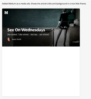

Yes, but not in a way that I control. Medium's layout apparently has a fixed height, that's why it doesn't fill the whole space.
On a related note, I'm thinking about replacing the option for responsive embeds with a simple on/off checkbox instead of a max width. That would prevent embeds from growing bigger than their original size and fix this particular issue. On the other hand, it limits the dimensions of videos to their original values which are relatively small. Usually 560 × 315, the default YouTube size. Not sure which one is worse, embeds that grow too big or embeds that are too small.

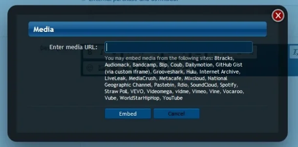

How do you exclude certain media sites? I tried going to ACP>> Options>>> s9e Media Pack >>> Excluded sites: i tried using "Amazon Product" also "http://affiliate-program.amazon.com/" as well as "affiliate-program.amazon.com" and "amazon.com" separately but no luck. After saving the field appears blank and Amazon Affiliate still available for selection.

Thank you. I get what you are saying now. I added "Amazon Product" to the "Excluded sites" field and saved. It then changed to "amazon" and removed it from the list. But this is not the same when adding multiple media sites to be Excluded.
As you can see from the screen shot above they are all added but in the below screen shot they all still appear except amazon.

I've seen this issue before. The media sites are actually excluded (you can check this by trying to add a URL from one of these and they won't work). I think it may be a caching issue? Previously I had this problem (before I used this add-on, so I don't think it's related to this) where I'd added a media site and then later removed it, however it was still showing in the media overlay on the forums. At the time the only solution I found was to rebuild the master data, which is rather excessive to have to do this. I did try now to remove a media site and then to run the XML file again in the hope that the template rebuilds would sort this, but it didn't. I also ran various cache rebuilds in the ACP but to no avail.

As others mentionned, it's by site ID. For Amazon, it's "amazon" (case-insensitive.) Have you tried posting a supported URL to see whether it gets embedded? You can get a list of supporter URLs on the add-on's GitHub page: https://github.com/s9e/XenForoMediaBBCodes
@Jahsun and @DennisSkov can you help me understand, why is it that you want to exclude some sites? The interface for excluding sites is very rudimentary because I didn't expect people to have to use it.
I had the same problem and clearing my browser's cached fixed it. That's because the overlay is loaded via an HTTP request that's apparently set to be cached (in the browser) for one hour. It's basically just a visual bug that affect a small percentage of the users though. If you didn't use the Media overlay in the hour preceding the change you're not affected.
