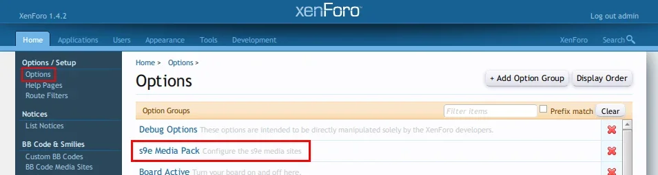

I've been working on the add-on refactoring (previously highlighted in this post) this week-end. I have released a preview on GitHub if anyone's curious and/or adventurous. It would help me if some of you would give it a try and confirm that it works fine. A lot of things have changed internally but almost nothing's changed from the admin's point of view.
In this release, you can select which categories of media sites you want to use without reinstalling the add-on. If you install this preview you will be able to reinstall the old version without uninstalling it first. However, if you do you will lose the value of s9e_EXCLUDE_SITES so copy/paste it somewhere safe if you use this feature.
Note that this version displays a small link back to the add-on's page at the bottom of the your forum's page. I intend to make it optional but I haven't found how I can do that without reinstalling the add-on yet.
