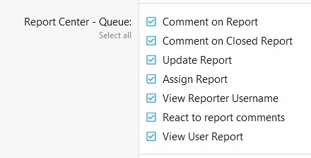

I am Super administrator and All are set by default. This issue only happened after 2.10.5 update.

Getting this when clicking on either "IP" or "Edit" in a report. Permissions are set to Yes for the entire Report Center.

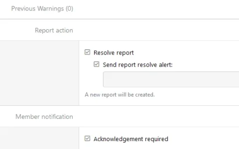

Previous warning editing only allowed adjusting the expiry date. The full form in an overlay has a number of UX issues and it was just easier to make it show up on a new page.

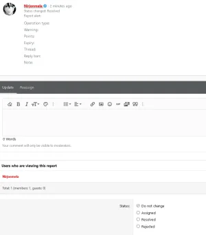

I'm not sure if this is from Report Improvements or Warning Improvements...

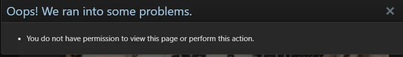

Under Reports, where this is a discussion with moderators and admins, there is an Edit button under an entry. However, when I click on Edit, I get this error:
Oops! We ran into some problems.
  • You do not have permission to view this page or perform this action.
Obviously, the first part of that is silly because I am right there viewing the page. But why can't I perform the edit action? I am a Super Administrator and Moderator with virtually all group permissions set to Yes.
Is this a bug? Or am I missing something?
