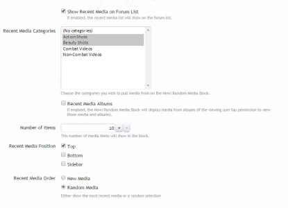

I don't consistently see the random media block. I'm on XFMG 1.04, but also had the same problem on 1.02 prior to upgrading. The block is set to pull from a pair of categories, both of which have a decent number of images in them. I know that before moving to 1.02 I did consistently see the block, but I don't know if I stopped seeing it at the time of the upgrade to 1.02 or not, as I only noticed this past week that I wasn't seeing it (I don't generally actually look at my forum list apparently).
Is this something I've misconfigured somehow?

It might be useful for you to post the site URL here and details of the media block settings in the ACP.

Do you have limits on what the block can contain? Notably, not including albums?

Ah, I see the problem looking at how the media is picked. Since my users have been piling stuff into personal albums and not the categories as of late, it is increasingly likely as time passes that the selection query will find nothing and thus display no block.

You can workaround it now by adding albums to the selection "pot" for it.
I could... if I wanted to display some of the random things my users have uploaded to their albums, which I don't.
