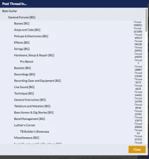

Suggestion: The "Post thread in..." popup is messy in the right column:
Would suggest truncating the thread counts (190k instead of 190051 like XF2 does). Also "Thread" should be "Threads" :)

The fix is implemented now, we will release it soon.

We will release the fix for thread count formatting soon.

AddonsLab updated Quick Thread by AddonsLab with a new update entry:
Thread count formatting change and a phrase fix
This is a minor update fixing a phrase and implementing formatting of large thread numbers as in XenForo 2.x
