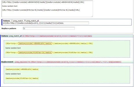

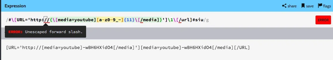

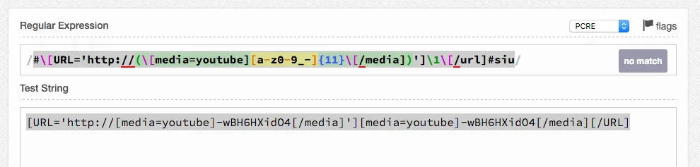

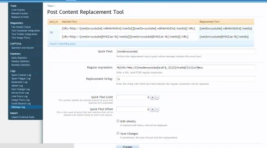

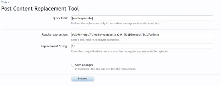

I've been trying for a couple of hours to try and fix some old content I've found on my site, but seems my regex building is just not strong enough and/or I'm not grasping it properly.
I'm trying to change;
[URL='http://[media=youtube]-wBH6HXidO4[/media]'][media=youtube]-wBH6HXidO4[/media][/URL]
into
Could anyone assist with the correct regex please?
into
Try this (untested as of yet)
Quick Find:
[media=youtube]
Regular expression:
#\[URL='http://(\[media=youtube][a-z0-9_-]{11}\[/media])']\1\[/url]#siu
Replacement String:
\1
