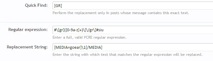

The following worked for me:
7800 posts edited and working :)
Thanks a lot for your help!! I appreciate it.
Glad I could help :)
I see that you have put it between media tags, nice job.
Yes I figured that out, in my vbulletin site I had a custom bbcode for goear, and this bbcode was activated with the [GR] [/GR] tags.
I created a new bb code media site for goear

And with the code you shared with me I edited around 7800 posts :)
Thanks again.
