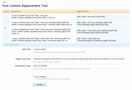

Hi!
How can I replace this:
<a class="postlink-local" href="http://test.com" onclick="window.open(this.href);return false;">Test</a>
... with this:
http://test.com
.... or to this:
Test
Quick Find: <a class="postlink-local"
Regular expression: #<a\sclass\=\"postlink\-local\"\shref\=\"([^<\"]+)\"\sonclick\=\"window\.open\(this\.href\)\;return\sfalse\;\"\>([^<\<]+)<\/a>#siu
Replacement String: [URL="\1"]\2[/URL]

Ooh, sorry, really don't understand much of these now. Is it ok? Can I save this?Also I need a better description of what it is you are showing me in replacement text. What you have shown there is the second subpattern
the replacement (Which I put single quotes instead of double accidentally) should include at least this much
[URL="\1"]\2[/URL]
...says to put the first captured subpattern after the = sign inside the first set of brackets, and put the second captured subpattern in between the two sets of brackets
<a class="postlink-local" href="http://test.com/viewtopic.php?f=25&t=265" onclick="window.open(this.href);return false;">viewtopic.php?f=25&t=265</a>
should become
[url="http://test.com/viewtopic.php?f=25&t=265"]viewtopic.php?f=25&t=265[url]
Ok, sorry. New here and thank you for that!
I've just put your instructions inside and click Proceed. Then I've pasted you what I get.
Or maybe I'll send you some examples again so you can write me instructions again.
Here you are.
<a class="postlink-local" href="http://forum.test.com/viewtopic.php?f=25&t=265" onclick="window.open(this.href);return false;">Something</a>
<a class="postlink-local" href="http://forum.test.com/viewforum.php?f=24" onclick="window.open(this.href);return false;">Something1</a>
Oh, and all those links are redirected now to my new board (if it has something to do with it).
<a class="postlink
[URL="\1"]\2[/URL]
