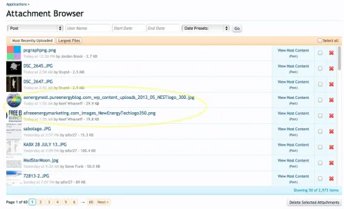

Rehosted files can be identified in the attachment browser by their long file name starting with a.
I've verified that the attachments behave as they are supposed to. When you permanently delete the post that the attachment is from, then the attachment is deleted too. The MetaMirror attachments can also be deleted from Attachment Browser (i.e. they are just regular attachments - I was worried they were not hooked in somewhere, but all seems well).
