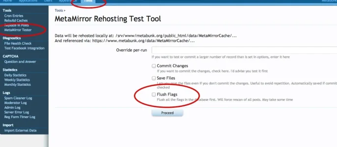

To flag images in an existing MetaMirror install, you will need to Flush Flags in the MetaMirror Tester (see attached image)
Once it has run, you can find broken images with the Post Content Find / Replace tool:
http://xenforo.com/community/resources/post-content-find-replace.1549/
Quick Find: Broken External
Regular Expression: #\[B\]\[Broken External Image\]\[\/B\]:\[URL\]([^\[]+)\[/URL\]#siU
(Don't click Save Changes here, unless you want to erase all the broken images).
  • MetaMirror Rehosting Test Tool | Admin CP - Metabunk 2013-12-29 09-58-04.webp

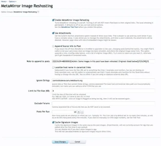

- Added option to use attachments insteda of file system
- Added option to limit file size
- Added option to add info to altered posts
See attached image
