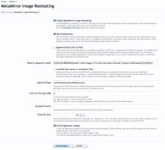

Step 2. Configuration
Go to Options -> MetaMirror Image Rehosting
Do not enable it yet
Add any ignore strings. This would be any different host you use for images, or a CDN, or just a site or dynamic image url you want to ignore.
Add Exclude forums - if you don't want a forum to be scanned, then add the forum ids here.

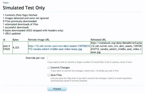

Step 3: Testing
Go to Tools -> MetaMirror Tester (in the left sidebar menu)
[NOTE: The following is for linked images re-hosted as files. If you use the attachments system, then the "Rehosted URL" will point to a temporary file, and then to the attachment after you commit the changes]
Verify that the data rehosting path and the file reference path are correct.
Leave the "Commit Changes" and "Save Files" options unchecked, and click on "Proceed" to run a non-destructive test.
Assuming you have some images to rehost, you will get something like:
Verify this seems correct. Then Click on "Save Files", and re-run, you should get:
Notice the Rehosted URLs are now active links. Click on the link to make sure the image has been rehosted correctly, and is web accessible at that URL.
Then click on "Commit Changes" and Proceed, you should get:
The bytes downloaded are listed as zero, as you have already downloaded the file. Now just verify the that post has been modified (go to http://example.com/posts/[post number]
Check the image displays, and that it's actually using the local URL.
You should then try a few more times, look at the URLS, and ensure things are working.
If you want, you can temporarily increase the number of IMG posts scanned per run with "Override per-run", so you can see what a reasonable maximum is for your server. Or if you just want to convert a bunch of links manually.
If all seems well you, can enable MetaMIrror in the options, like this:
